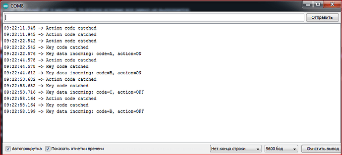

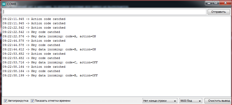

const uint8_t kaNone = 0x00;
const uint8_t kaOn   = '1';
const uint8_t kaOff  = '0';
typedef struct {
  uint8_t action;
  uint8_t code;
} panelKey_t;
panelKey_t getPanelKey() {
  static uint8_t action = kaNone;
  panelKey_t result = {.action = kaNone, .code = 0x00};
  int16_t reading = Serial.read();
  // read() returns -1 on empty Serial buffer
  if (0x00 <= reading) {
    uint8_t currentByte = (byte) reading;
    if (kaOn == currentByte || kaOff == currentByte) {
      Serial.println("Action code catched");
      action = currentByte;
      if (kaNone != action) {
        Serial.println("Key code catched");
        result.action = action;
        result.code = currentByte;
        action = kaNone;
  return result;
  panelKey_t panelKey = getPanelKey();
  if (kaNone != panelKey.action) {
    Serial.print("Key data incoming: code="); Serial.print((char)panelKey.code);
    Serial.print(", action="); Serial.println(kaOn == panelKey.action ? "ON": "OFF");
