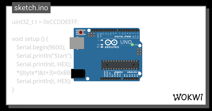

uint32_t t = 0xCCDDEEFF;
void setup () {
   Serial.println("Start");
   Serial.println(t, HEX);
   *((byte*)&t+3)=0xBB;
