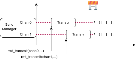

Выдержки из документации:
The RMT (Remote Control Transceiver) peripheral was designed to act as an infrared transceiver. However, due to the flexibility of its data format, RMT can be extended to a versatile and general-purpose transceiver, transmitting or receiving many other types of signals.
ESP32-S3 contains multiple channels in the RMT peripheral (Remote Control Transceiver (RMT) - ESP32-S3 - — ESP-IDF Programming Guide v6.0.1 documentation). Each channel can be independently configured as either transmitter or receiver.
Typically, the RMT peripheral can be used in the following scenarios:
  • Transmit or receive infrared signals, with any IR protocols, e.g., NEC
  • General-purpose sequence generator
  • Transmit signals in a hardware-controlled loop, with a finite or infinite number of times
  • Multi-channel simultaneous transmission
  • Modulate the carrier to the output signal or demodulate the carrier from the input signal
    In some real-time control applications (e.g., to make two robotic arms move simultaneously), you do not want any time drift between different channels. The RMT driver can help to manage this by creating a so-called Sync Manager .
