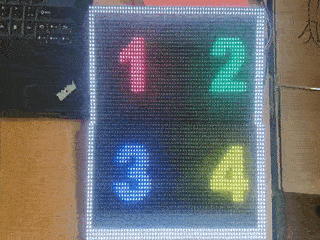

Здравствуйте! Странно работает функция поворота экрана setRotation().
Код
#include "DMD_RGB.h"
#include "hz2.h"
//Number of panels in x and y axis
#define DISPLAYS_ACROSS 1
#define DISPLAYS_DOWN 2
// Enable of output buffering
// if true, changes only outputs to matrix after
// swapBuffers(true) command
// If dual buffer not enabled, all output draw at matrix directly
// and swapBuffers(true) cimmand do nothing
#define ENABLE_DUAL_BUFFER false
// ==== DMD_RGB pins ====
// mux pins - A, B, C... all mux pins must be selected from same port!
#define DMD_PIN_A PB6
#define DMD_PIN_B PB5
#define DMD_PIN_C PB7
#define DMD_PIN_D PB8
#define DMD_PIN_E PB9
// put all mux pins at list
uint8_t mux_list[] = { DMD_PIN_A, DMD_PIN_B, DMD_PIN_C, DMD_PIN_D, DMD_PIN_E };
// pin OE must be one of PB0 PB1 PA6 PA7
#define DMD_PIN_nOE PB0
#define DMD_PIN_SCLK PA10
// Pins for R0, G0, B0, R1, G1, B1 channels and for clock.
// By default the library uses RGB color order.
// If you need to change this - reorder the R0, G0, B0, R1, G1, B1 pins.
// All this pins also must be selected from same port!
uint8_t custom_rgbpins[] = { PA0, PA1, PA2, PA3, PA5, PA6, PA7 };  // CLK, R0, G0, B0, R1, G1, B1
// Fire up the DMD object as dmd<MATRIX_TYPE, COLOR_DEPTH>
// We use 64x32 matrix with 16 scans and 4bit color:
DMD_RGB<RGB64x32plainS16, COLOR_4BITS_Packed> dmd(mux_list, DMD_PIN_nOE, DMD_PIN_SCLK, custom_rgbpins, DISPLAYS_ACROSS, DISPLAYS_DOWN, ENABLE_DUAL_BUFFER);
// other options are:
// <RGB32x16plainS8> -  32x16 matrix with 8scans
// <RGB80x40plainS20> - 80x40 matrix with 20scans
// <RGB64x64plainS32> - 64x64 matrix with 32scans
// Color depth - <COLOR_4BITS_Packed> or <COLOR_4BITS>
// <COLOR_1BITS> mode is not recomended for bitmap
#define BRIGHTNESS_DEFAULT 50  // (brightness 0-255, recomended 30-100)
// bitmap images to show
const uint16_t* bitmaps[] = { hz2 };
uint8_t ptr = 0;
  setup
  Called by the Arduino architecture before the main loop begins
int i = 0;
void setup(void) {
  // initialize DMD objects
  dmd.init();
void loop(void) {
  dmd.setRotation(i++);
  dmd.drawRGBBitmap(0, 0, bitmaps[0], 64, 64);
  delay(5000);
  dmd.clearScreen(true);
результат:
video_2023-04-05_11-11-11
красиво :slight_smile:
