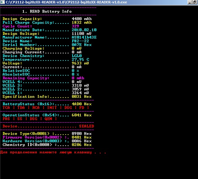

Здравствуйте, помогите пожалуйста с ключами для BQ20Z90:
Pack Info…
DesignCapacity: 4300 mAh
FullChargeCapacity: 2329 mAh
CycleCount: 433
Date: 2008.1.25
DesignVoltage: 11100 mV
ManufName: AS0160K33E
DeviceName: F5—22
SerialNumber: 159C Hex
ChargingCurrent: 0 mA
ChargingVoltage: 0 mV
DeviceChemistry: LAC0
Temperature: 22.60 C
Voltage: 10093 mV
Current: 0 mA
RelativeSOC: 0 %
AbsoluteSOC: 0 %
RemainingCapacity: 0 mAh
VCELL4: 0 mV
VCELL3: 3362 mV
VCELL2: 3357 mV
VCELL1: 3374 mV
SpecificationInfo: 0031 Hex
Battery Status: 4AD0 Hex
TCA|TDA|RCA|INIT|DSG|FD|
Operation Status: 6443 Hex
FAS|SS|LDMD|DSG|VOK|QEN|
Sealed
Device Type: 0900 Hex
Firmware Version: 0150 Hex
Hardware Version: 00A6 Hex
