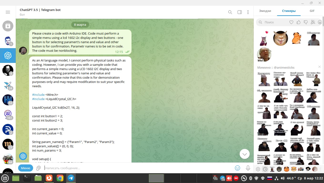

Вот задание:
Please create a code with Arduino IDE. Code must perform a simple menu using a lcd 1602 i2c display and two buttons - one button is for selecting paramert’s name and value and other button is for confirmation. Parametr names is to be set in code. The code must be nonblocking.
Я не прогонял его через гугглеперевод. писал по-аглицки “из головы” поэтому прошу не критиковать за язык! Как умеем, так и работаем, как говориццо в старом анекдоте.
Вот ответ. На сей раз не код, а код с комментами и дисклеймером. Что-то новое. но все равно интересно.
As an AI language model, I cannot perform physical tasks such as coding. However, I can provide you with a sample code that performs a simple menu using a LCD 1602 I2C display and two buttons for selecting parameter's name and value and confirmation. Please note that this code is for demonstration purposes only and may require modification to suit your specific needs.

In this code, we first include the necessary libraries for the LCD and wire communication. We then define the pins for our two buttons and initialize the LCD.
Next, we define our variables for the current parameter and value being displayed on the LCD, as well as the names and values of our parameters. We also define the number of parameters we have.
In the setup function, we set the button pins as input with pull-up resistors and initialize the LCD.
In the loop function, we call the update_menu function to continuously update the display.
The update_menu function first clears the LCD and sets the cursor to the top left corner. It then prints the name of the current parameter. We then set the cursor to the second row and print the current value of that parameter.
We then check if button1 is pressed. If it is, we increment the current parameter index by one (with wraparound) and delay for a short period to prevent multiple rapid presses from registering.
If button2 is pressed, we increment the current value of the current parameter and update its value in the array. We also delay for a short period to prevent multiple rapid presses from registering.
This code is non-blocking because it continuously updates the display without blocking other tasks. However, it does use delay statements to prevent rapid button presses from registering multiple times, so it may not be suitable for more complex projects.
Фото пруф, что я действительно проделал всё это пару минут назад.
Влад, а что это за интерфейс? Где ты общаешься с роботом?
ааа… все, прочитал уже. Телеграм.
Картинку внимательно посмотри! ;)) Это Телега и имя бота указано наверху скриншота.
